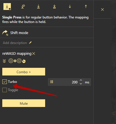

    The behavior you need can be implemented using a combo in Execute at once mode and applying Turbo to it.
    For the second button press in a combo, set a very long pause between pressing and releasing the button.
    Thus, while you hold the button, the second press of the combo will be held until you release the button or until this infinitely long pause passes.
    Here is an example of such a combo:
