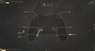

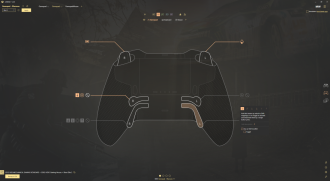

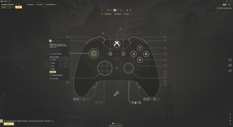

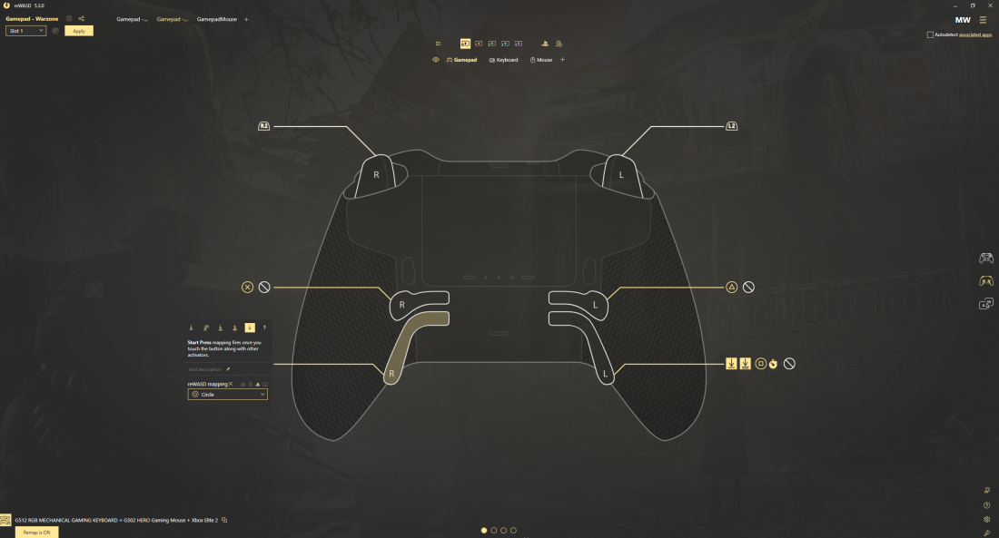

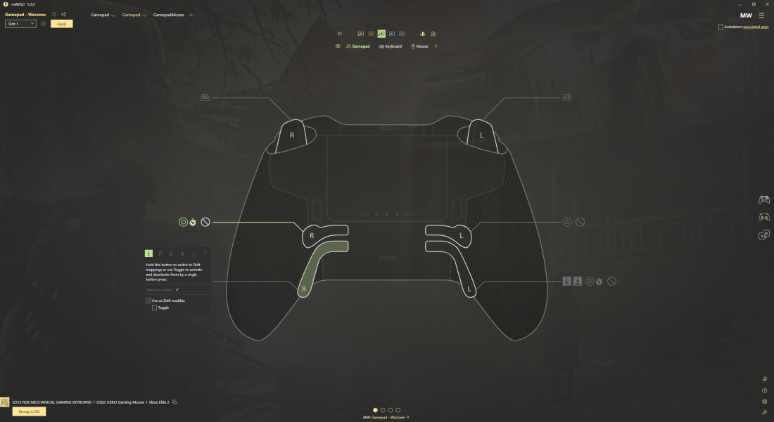

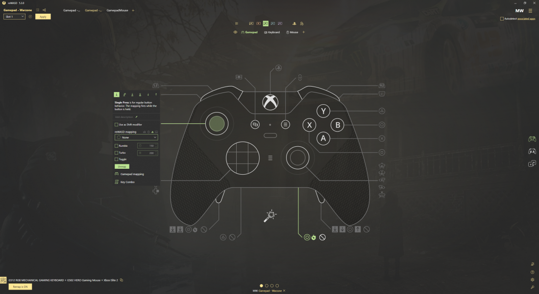

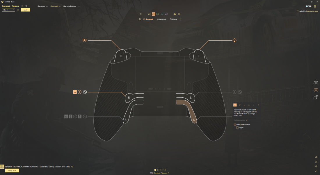

        I ran into a very similar issue. I also use an elite controller with paddles and I use rewasd to remap it.
        Let me describe my configuration.
        Since the game doesn't offer an option of holding or toggling for crouching for controllers this is what I did:
Name:	Screenshot (137).png
ID:	218951Click image for larger version
Name:	Screenshot (139).png
        I am simulating O on start press and X on release press of the right lower paddle to simulate a hold version of crouching. In order for this to work properly I have to block sprint when crouching because the game cancels crouch when you sprint and then the player would jump when the button is released. So this is how I solved this:
Name:	Screenshot (140).png
ID:	218953Click image for larger version
Name:	Screenshot (141).png
        The same paddle works as a shift button that enters a layer (shift layer 2) where the run button (L3) is unmapped. Everything is good so far. The issue appears when another shift layer is introduced. I use the left lower paddle also as a shift button to access another shift layer (shift layer 1) with some support actions.
Name:	Screenshot (142).png
        If I hold down the shift layer 1 button, then hold crouch (the first shift button described which is also shit layer 2 button) and release shift layer 1 button again, the X button which is supposed to be simulated when the original button is released is never performed. Instead the action is transfered to the shift layer 1 button and the first time I press it again X is triggered the player jumps. I am sure that this is unwanted behaviour and it causes issues because the only way be avoided is by remembering to release shift layer 2 button before shift layer 1 button.
        I agree with oblivioncth on having the option to cancel combos when a shift button is released. Another feature that I think would be nice to exist is having the option of accessing other shift layers without previously releasing shift buttons currently held down. I understand that this could cause some weird behaviours but it can be solved by only accessing the layer of the latest shift button pressed and completly ignoring all previous shift buttons held (it would also be nice to have the ability to choose whether you can return to a previous shift layer that its button is still held when latest one is released or completely ignore all previous layers until their buttons are released).
        Don't get me wrong. This software is already amazing. It offers much more than the official software provided by the manufacturer but small details like this would provide much greater functionality and make this app really shine.
        Also another thing noticed is that some games do not recognize the virtual xbox 360 controller. This is also the reason I am using a virtual ds4 controller.
