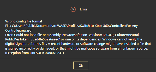

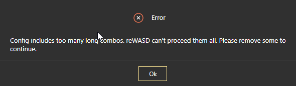

    Hello, I have an issue and have had this issue for the last few months. When I load reWASD I get an error prompt followed by another. I hit okay on these and things work just fine, but it's rather annoying. I have deleted the configs and just loaded default ones, but as soon as I save any config, even without changing any button mappings, this error will pop up.
    I develop Minecraft plugins and use JSON libraries to do so, which I am assuming is the issue here since I have installed my own libraries.

    This is an error that definitely comes from some issues with JSON library.
    If you could remove it just to be sure that it is a case of a problem, it would be truly helpful for us.
    Unfortunately, at the moment, we can't reproduce this error from our side.
