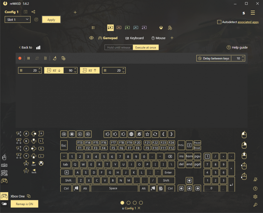

      Please make the combo as on this screenshot:

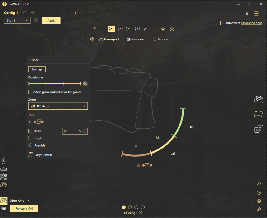

      And assign it to the high zone of the trigger.
      In the main page of reWASD, assign 'Gamepad mapping' to the right trigger.
      By assigning this combo to the trigger, you will cause it to be unpressed and pressed again from time to time. Important thing is to get a pause between iterations for Toggle more than the pause between iterations in the combo itself.
      Still, feel free to adjust the pauses to better suit your needs.
