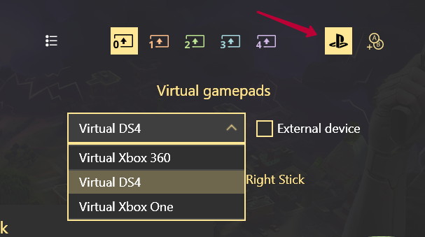

    Hello! It may be a chance that the game doesn't detect the virtual controller.
    Please try the following:
    - unplug any physical controllers you may have
    - restart the game with all launchers after you applied a config and check again
    - try other types of virtual controllers here:

    After the new one, please restart the game one more time.

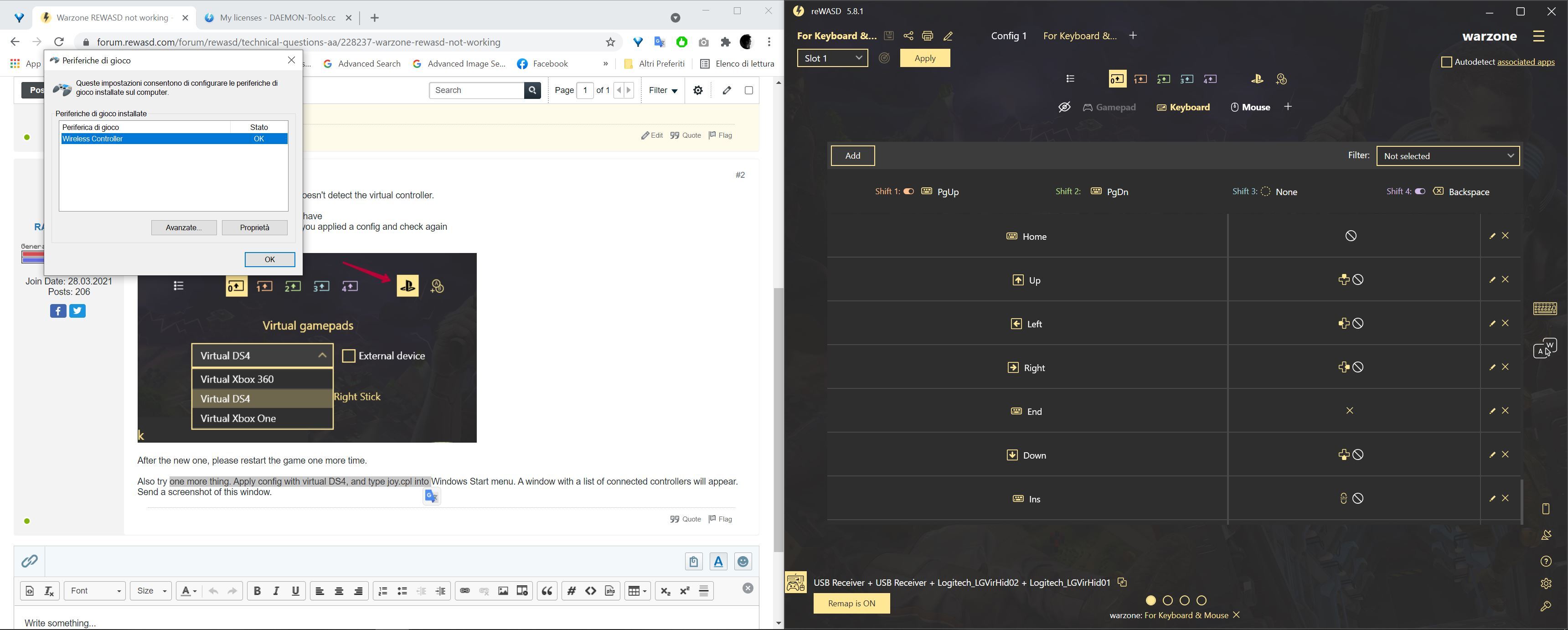

    Also try one more thing. Apply config with virtual DS4, and type joy.cpl into Windows Start menu. A window with a list of connected controllers will appear. Send a screenshot of this window.
      Thx for the quick answer! i don't have any other physical controllers, i restarted with wasd applied without switching config and i also added to the wasd config other 2 hardware ids that it found on restart (even in i have only 1 m&k).
ID:	228243the screenshot shows only one controller and i verified that the controls match.
      but in game same problem as before
