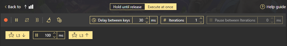

    You can use Zones for such case. In your case, you will need to add a mapping to High zone. Using Zone Shape slider, please set the value you need: it should be 31130 (95% * 32768).
    Once you add L3 to stick, it will be pressed and held all the time while you are inside this zone.
    If you need it to be pressed only once, then please use Combo (Execute at once mode, [L3-press] [pause (about 30 ms)] [L3-release]).

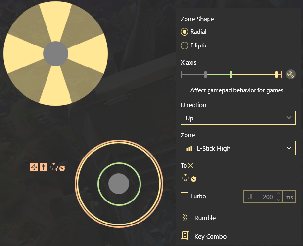

      I tried to set zone but it doesnt work.
      What am i doing wrong?

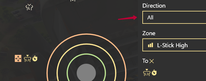

        Please ensure that you have added a combo to All directions, I don't see what you have there:

        As for Up direction, I think it should be removed, because you will get 2 stick presses when you go Up, and the running mode will be switched off I guess.
          Windows was not using the virtual controller for the game.
            Let me clarify, was this an issue and has it been resolved, or is Windows still not recognizing the controller?
              It has been resolved.
