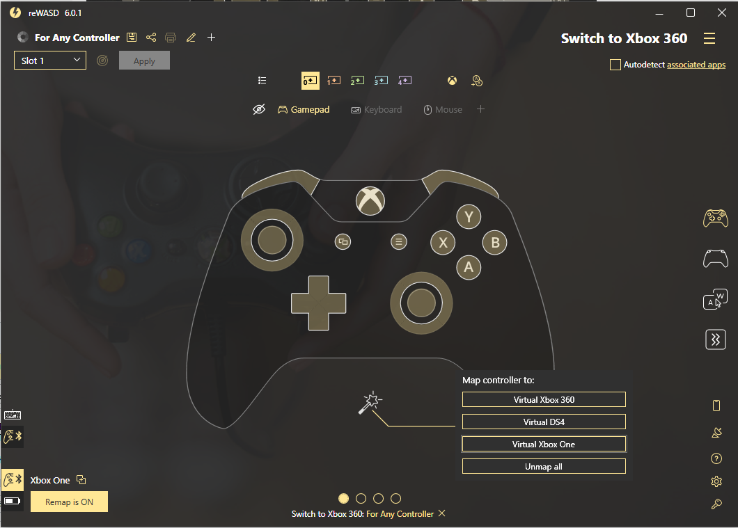

      I don't really understand what it means. Under "Virtual controller settings" I have it mapped to "Virtual Xbox One".

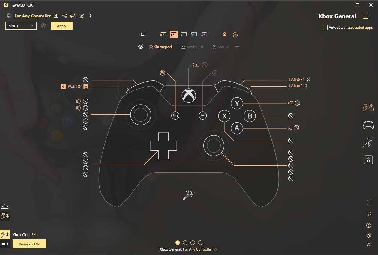

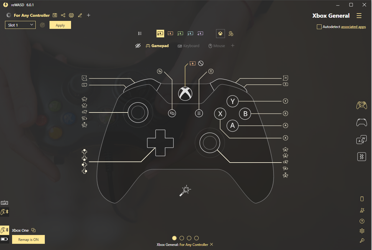

      I attached screenshots with my config.

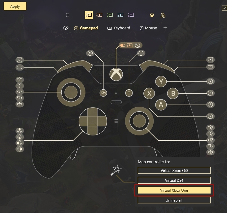

        Yes it is. Try to remove the "Virtual Xbox One" through the magic wand, apply the config and see if the issue persists.
          You mean do the "Unmap all" option? Then I will lose all the input.
            Yes. The controller buttons will be muted and only the mappings you have assigned will work.

                Disable virtual controller here. You need to click on the Xbox One so that the automatic mappings disappear, then save the config.

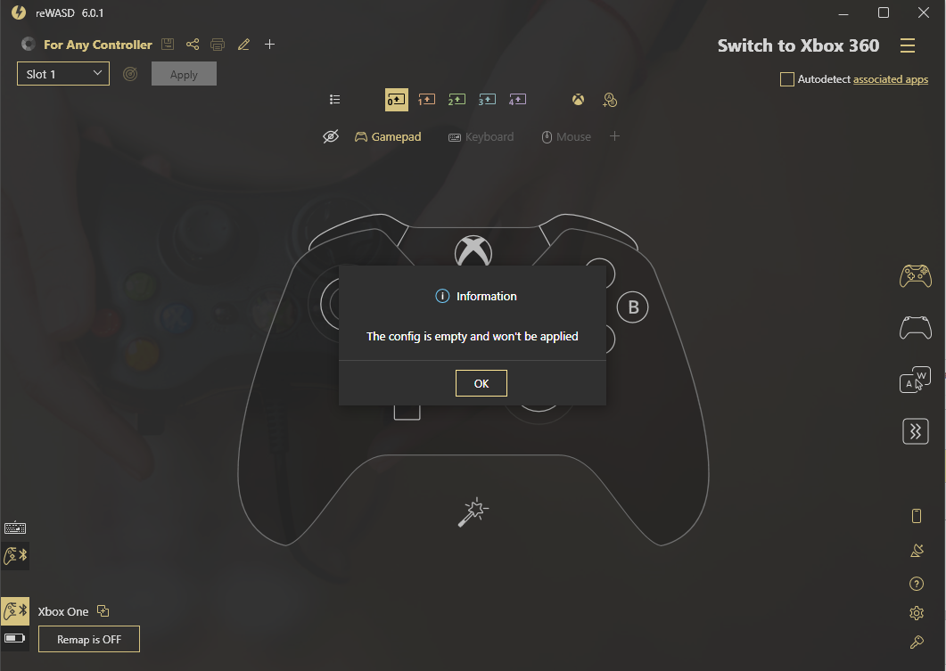

                    If I do this "Apply" button becomes gray and I can't apply config. If I save this config, I can't enable remap, the error will pop up.

                      It seems to be a different config, because the one you have shown above included Shift mode with keyboard mappings, so in that case, the virtual controller is not required.
                      Could you please describe what exactly you want to achieve with reWASD?
