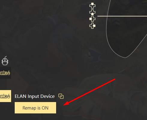

    Hello! When the config is applied to the device, Remap is ON will be written at the bottom left. Click this button to disable the active config.
    Click image for larger version  Name:	Screenshot_1.png Views:	0 Size:	139.7 KB ID:	231724
    You can also disable the remap by pressing Ctrl+Alt+Delete or using the relevant option in tray agent.

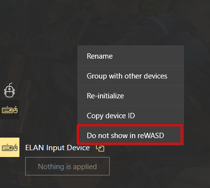

          When the config is not applied, reWASD no longer affects the device. You can blacklist it to check - right-click on the device and select Do not show in reWASD.
          To later remove a device from the blacklist, go to Preferences → Blacklist.
