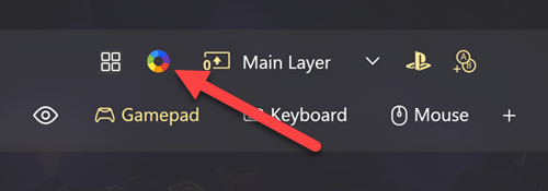

    Hello all! I have been using reWASD for some time now and absolutely love it! Recently I started using a dual sense controller and have mapped it to my liking except for the mic mute button. While the functionality of the button works great, I would love to be able to tell when the mic mute is active as the solid glow of the button is on continuously. I was hoping I would be able to change the main LED of the controller face from GREEN ( not-muted) to RED (muted) and back to green when using the mic mute button. Does anyone have any suggestions on this config?
    reWASD cannot detect whether the mic is muted or not, so it won't be possible to set up a config based on that.
    Though you could set up the [Mic] button to toggle between and Shifts which would have different LED settings.
