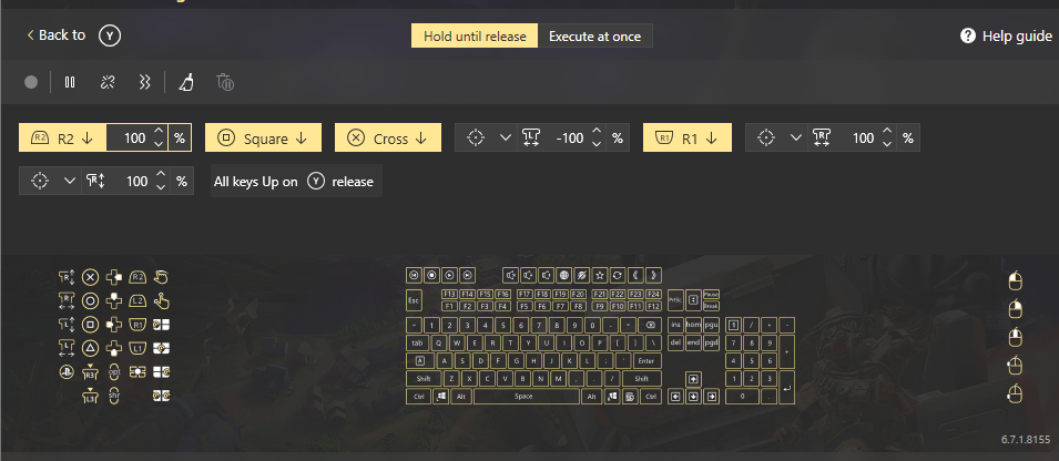

    If I got you right, your combo should look like this one

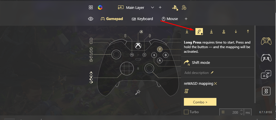

    Also, set up this combo to Long Press activator:

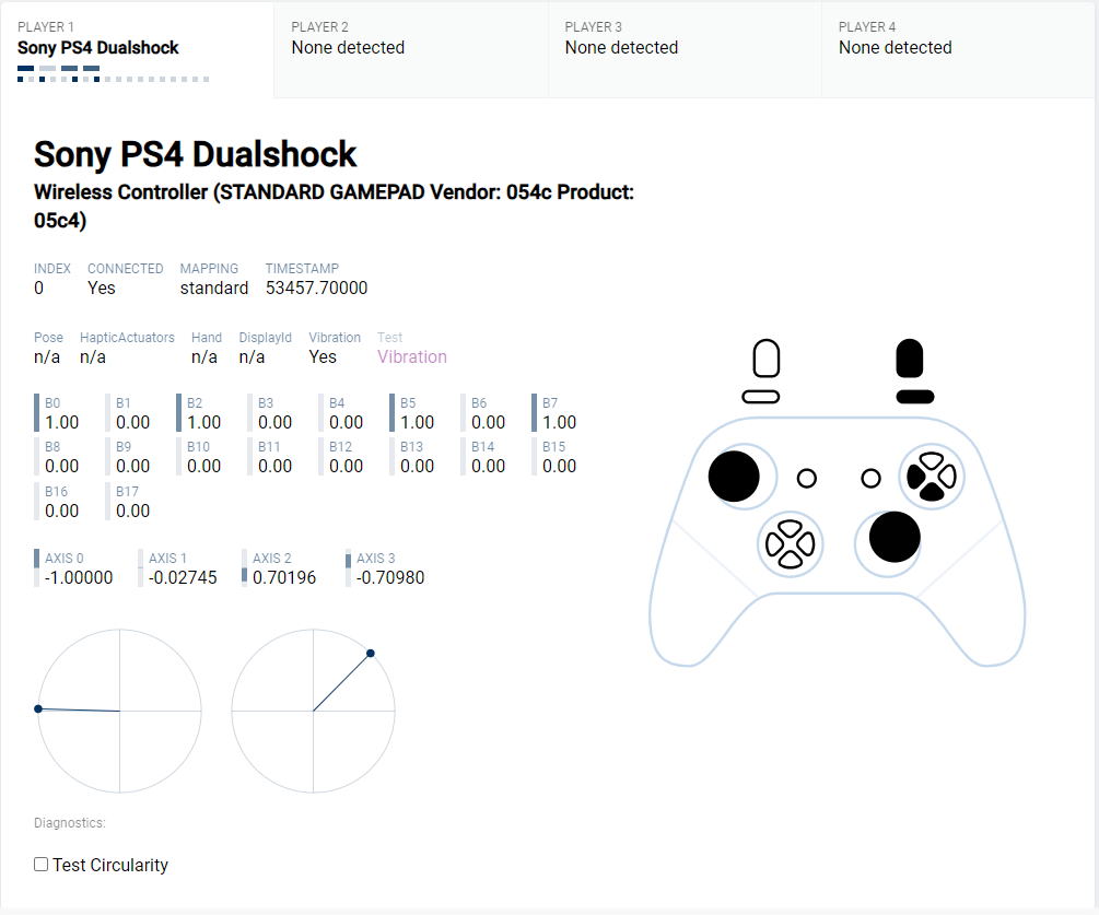

    This tester shows how your combo will reproduce while you hold the button
      I didn't notice that you tried to create two different combos. However, the sense is the same. You need to choose a Hold Until Release mode and create a combo. To understand on how to add a moves combo, please check this article.
