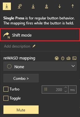

      Jump to Shift? Can you explain how to assign a control as the "Jump to Shift" key? Sorry, i read your guide but I can't understand better some words. can you help me? Thanks in advance.
        Hi joannefarland
        You can find and map a switch to the shift layer here (example in the screenshot)
        You can also learn more about Shift mode in this article.
