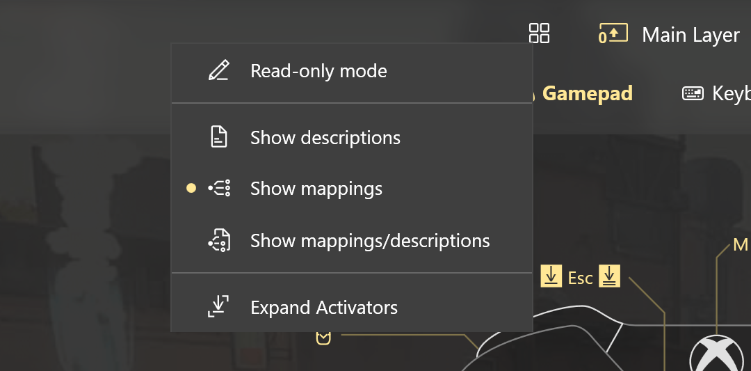

    • Manage how the config content is displayed with the View menu
    Want to change what is shown in the config right now? Tap the View button, and choose the option you find handy:
