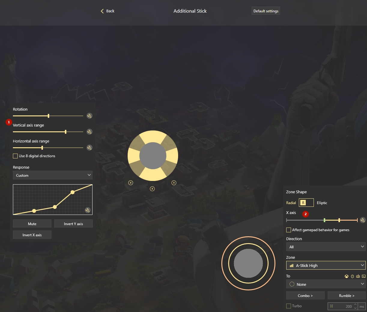

    It seems that getting a clear downward direction is due to the structure of the A-stick itself.
    If you use it in Additional mode and assign some digital mappings, then I would recommend increasing the Vertical Axis Range in Advanced stick settings. In this way, you will expand the range in which the mappings of the vertical directions of the stick will work.
    Also, if the stick seems too sensitive to you, increase the gray zone (deadzone) in the same settings section.

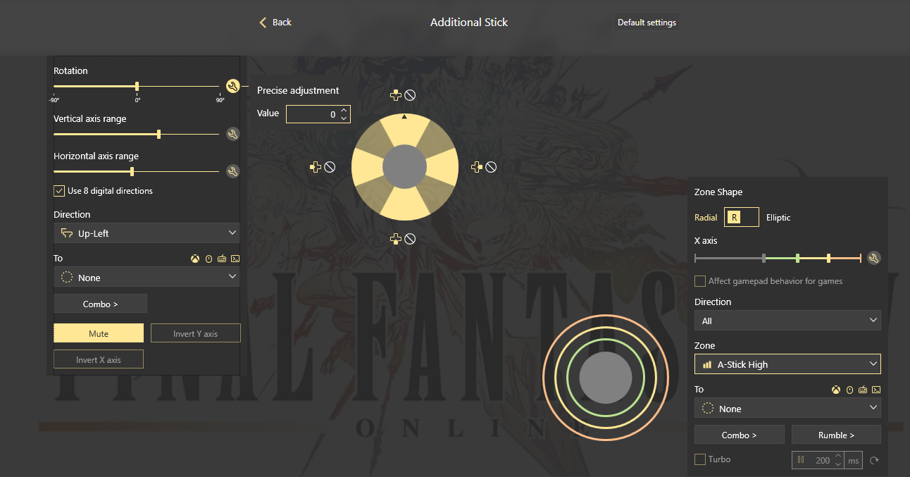

      I use it to mimic the Dpad on FFXIV, so I can use my right hand to send all actions without the need to remove my left hand from the stick and thus stop moving.
      Here are my settings, I have shortened a bit the axis range because otherwise it would do multiple directions at once. Having 8 directions selected allows for an "off" position in between.
