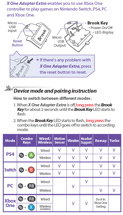

    4) Something like X1nput what is converting Xinput signal to Windows.Gaming.Input API and enabling trigger vibration for more games. Instead basic vibration we would get trigger too.
    5) Support for Brook X ONE Adapter (https://www.brookaccessory.com/detail/53818657/) to enable gyro support for Xbox One controllers. Adapter is pretending that Xbox One Controller turning into DualShock or Switch Pro controller, what spoils trigger vibration.

    5. Interesting, we have never tested this one, but it looks pretty cool. Do you have it? Once you switch to PS4 mode, does reWASD see it?

      5. I do not have it yet, but I am planning to buy to enable for my Elite Controller 1 bluetooth connection. I saw this on Gyro Gaming YT channel (@JibbSmart, author of Flick Stick is going to implement it in his software). From manual I see that it can pretend PS4/Switch/PC/Xbox One controllers, so reWASD should be able to see it without any problem. Switch mode should be the most efficient.

        5. We would be happy to get your feedback once you buy it. We will investigate it from our side too, quite an interesting device.

              We have bought Brook adapter for some tests. Yep, it is detected by reWASD in PS4 more with Xbox Elite and allows using gyro, nice :satisfied:
              However, only USB connections works properly, with Bluetooth, the device sends incorrect calibration data. Seems like a big issue.
              We have contacted the manufacturer but never got the answer unfortunately. If you are still planning to buy it, please be aware of the gyro issues with wireless connection.
                    Does reWASD detect both the Elite controller and the "PS4" gyro when PS4 mode is enabled?
                    I would like to be able to configure it such that I could get full use of the paddles of my Elite Series 2 controller, and add gyro capabilities, possibly through seeing the gyro output from the adapter as separate device. The ability to use gyro with an Elite Series 2 would make it the perfect controller for playing competitive FPS games on PC.
                    Brook has released this: https://www.brookaccessory.com/detail/43268489/ which works the Elite Series 2. It may be possible to have a Micro-USB connected to the adapter going to the computer, with another cable connected to the controller (so the adapter and the controller have separate inputs to the computer). In my mind, it should be possible to read just the gyro output from the adapter and tack that on to the configuration overlay for the Series 2, but software is not my specialty.
                    Does this seem feasible?
                    (amazon link: https://www.amazon.com/Brook-Adapter.../dp/B08L7LMBSL)
                      In PS4 mode, the device will be reported as DS4 controller, no paddles. At the moment, reWASD will see it as an ordinary PS4 controller in this case.
                      We can't add paddles support here from our side. We have tried to contact Brook for the partnership but never got any answer. You could try to reach their support team, maybe it will convince them to work with us
                      We haven't tested the new model, but most likely it also turns the controller to the DS4.
