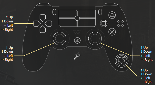

    • I just noticed that the description boxes for the DS4 D-Pad and Gryo aren't aligned to the line that goes between the controller overlay and the text box. With the joysticks I can assign a description to the Left Binding and it lines up with the indicator line but the same doesn't happen with the the D-Pad/Gyro -- it is aligned between two direction's description. If this doesn't make sense let me know and I'll provide pictures to better clarify.
    I'm sorry but yes, I need a picture. Not sure if I get you right.

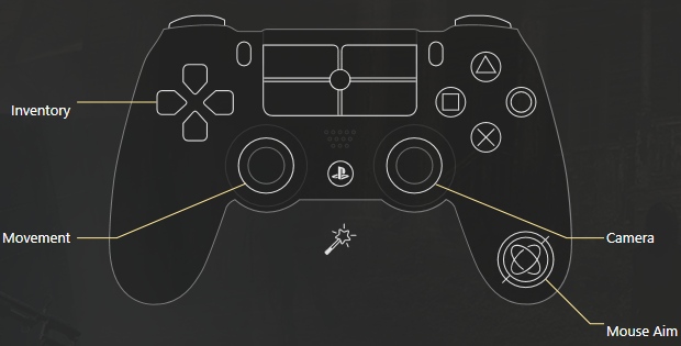

      Thanks for the full response! I'm excited to hear that some of this stuff is already on the to-do list. As for that final issue, here are some pictures to help demonstrate. In the first picture you can see that the yellow lines coming off of the joysticks line up perfectly with the Left Binding Name. For the Gyro and D-Pad though, the yellow line sits between the Down and Left Binding Names. So for instances where I want to attribute a single Binding Name to the Input Source -- such as "Movement" or "Camera Control" -- I'll assign just a single Binding Name to the Left direction and end up with a very clean look, as seen in the second picture. At least it's a clean look with the joysticks. This is mostly an OCD thing and doesn't affect the software at all but I'd really like for one of the Binding Names to line up with the yellow line coming off of the D-Pad and Gyro.

        Oh, I see.
        It happens because Gyro and D-pad has 4 controls while Sticks have 5 controls. The best way to make it look perfectly is to add 4 descriptions instead of one.
        I understand that it doesn't sound as a solution, but at the moment, we just have no ideas how to fix it in our current architecture, sorry
