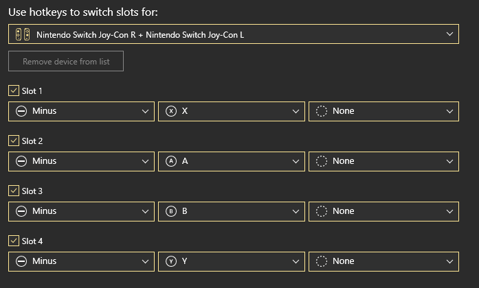

      2. Have you tested the hotkeys for changing the slot configurations for joy-cons? They work great on my DS4 controller. But for joy-cons they don't work. And I set up hotkeys for both controller.

          2. I am using split joy-cons. And trying to use the following button combination. I tried other combinations though.

            2. You right. It's a bug. Thank you for let us know it will be fixed next minor update. (during the September, according out plans).
              We have released reWASD 5.5.1, and it includes the fix for Slot hotkeys for grouped Joy-Cons. You are welcome to try it.​ The full list of changes is here.
