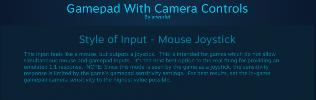

    I've been using a PS4 controller with your lovely program for about a week now to play shooters with Gyro assisted aiming and am loving it. My only complaint is having to use a games mouse and keyboard UI. I tried playing with just a virtual Xbox controller with the Gyro set to the right joystick but this method left the gyros movements stinted and awkward like it could only move vertically or horizontally individually and it wasn't anywhere near as smooth as the gyro to mouse setup. After some digging I found that Steam has an answer to this that I think ReWASD could really use. Steam has a mode called Mouse Joystick that does as the picture says and it feels exactly like a mouse after some tweaking and I get to use the Gamepad UI while I play.
    Any chance of having something like being implanted?Click image for larger version

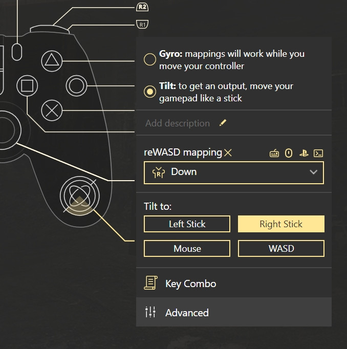

    Could you please try to check Tilt mode with mapping to the stick in reWASD? Does it feel better?
    Something like this:

      I've tried tilt mode, Unfortunately that still leaves the stiff feeling while aiming unlike setting the gyro to mouse but it also only seems to work with roll and I preferer Yaw. The Gyro feature works beautifully while set to mouse but when set to Stick it doesn't seem to mouse as smoothly (that being an understatement).
