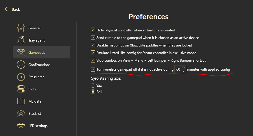

    Please add a way to keep xbox controllers always on, there is got to be a way to avoid the 15 minutes autoshutdown when not in use, I have old and broken controllers grouped to vibrate in sync to make force feedback stronger in games.
    Here is the option which may help.
      That is even worst because it causes my old dualshock 4 turns off too, I prefer to leave that option unchecked because it has no effect on xbox controllers but it turns off my otherwise always on ds4 off. Thanks for your suggestion.
        Thank you for your feedback.
        Please note, that due to hardware restrictions and the controller has to be switched off due to battery saving when it's not used.
        For Xbox controllers, the xbixgip (Xbox Game Input Protocol Driver) turns the controller off forcibly while the controller is idle. No ways to controls that, at least in the current reWASD version.
        Usually, it's around 15 min. Xbox, DS4 controllers have such hardware parameter and switches off no matter whether this option checked or not.
        This option works with devices that do not switch off automatically.
          That is really sad, I hope you will find a way soon, thanks.
            Hi there,
            It's required serious driver changing, but we will try our best.
