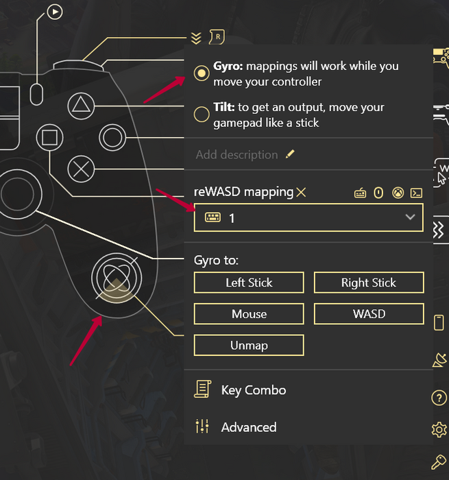

    and add a gyro axis mapping function,this makes it easy to play flight games(example GTA5 plane drive need controller LB and RB,need mapping to gyro axis )
    Not sure if I understand you correctly. Do you want to map something to the single axis of the gyroscope? If yes, it is also possible. Just choose the direction and then set a mapping you need from reWASD mapping list:

        2. i mean,look like u can use yaw+roll mode,and can set gyro mapping
        Sorry, still not sure what exactly you mean here. When you set mappings here, you use Yaw or Roll + Pitch axes. If you need to map the third axis, you should open Advanced settings here and add mappings to Lean Right and Left. So, all three axes could be remapped separately in reWASD.
