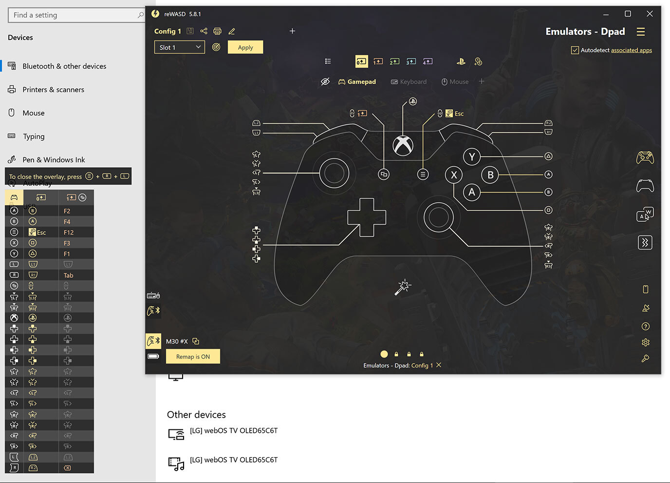

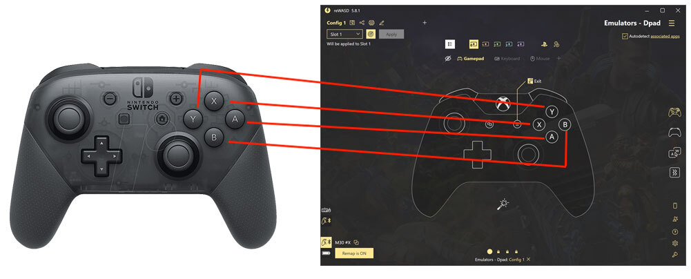

          Did some testing with "Advance Mapping" to see if can swap button A with button B when connecting Switch style controller as X-Input. This is how it connects:

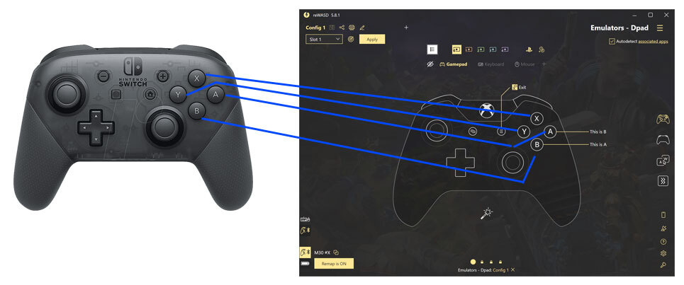

          This is what I wanted to end up with
          Gamepad mapping (part of Advance Mapping) able to do this but mapping overlay was not something i expected

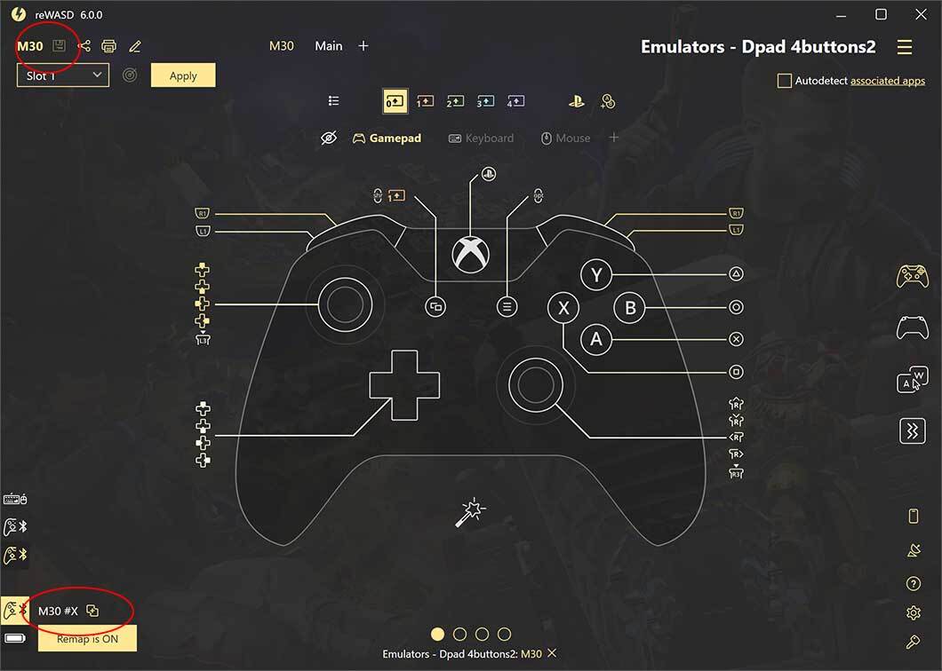

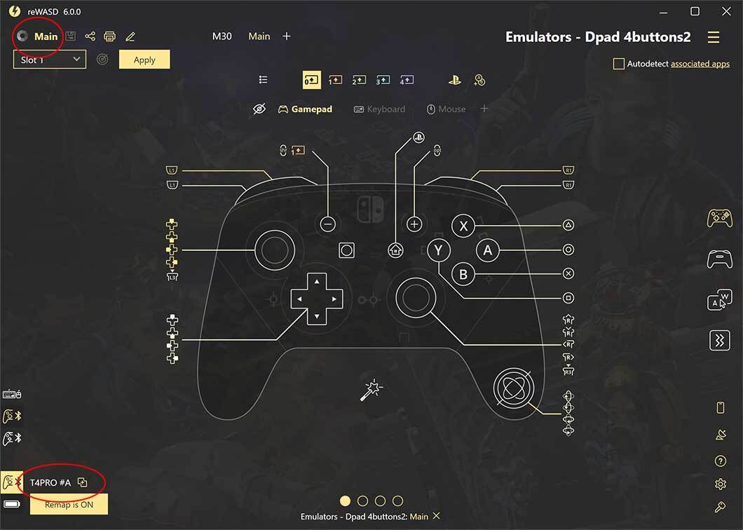

                    I didnt understand how ReWASD works ... dont even need to use 2 slots:
                    1. create config file for generic controllers ... create config file for 8bitDo M30
                    2. then assign those config file to appropriate controllers
                    WOW ... functional, simple, and elegant
                      That is truly an elegant solution, and it is enough to use different configs for the different devices, yes Great to know that the part of your request could be achieved already!
