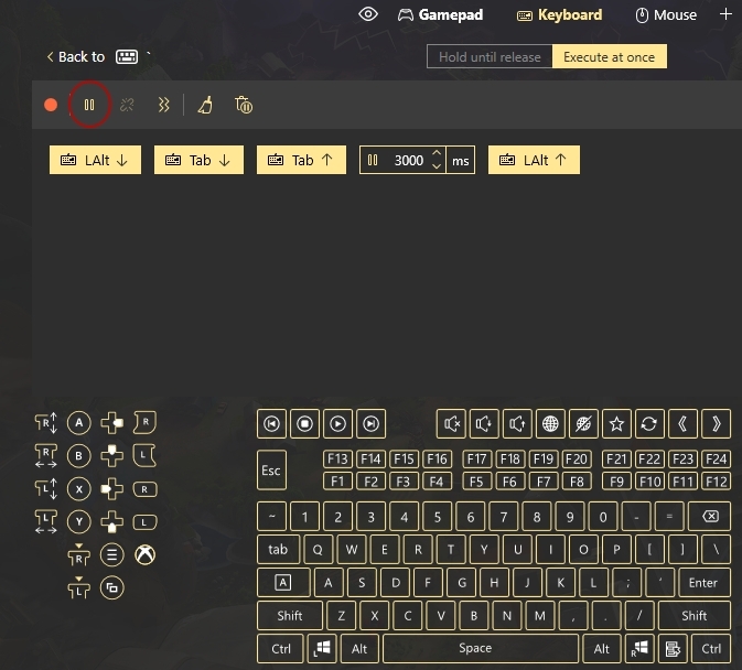

    in the combo page, it'd be very helpful to have release keys when using shifts. i want to execute a command but cant because the shift layer has a modifier - let me release the modifer.

      if i wanted to alt tab, i need to hold alt, but tab needs to be released otherwise it doesnt execute properly. having the option to choose what is held and what is released (tapped).
        Create a combo for the desired key as in the screenshot and check the Turbo checkbox.

        Thus, pressing this key will open a menu for switching between windows.
          The problem with this is the alt needs to be held before and after the tabs. using your suggestion kicks me out of the alt tab menu after 3000ms even with turbo.

            Maybe set [Toggle] flag for [ALT] key and have it mapped to [TAB] key via [Release Press] activator? Though this will add an unnecessary [TAB] input for the second [ALT] press, but once [Combo] will be available for all activators, that won't be a problem.
              You just need to add a bigger pause — if you use Turbo, then the combo will be stopped after you release a button always. So, this pause should be long — longer than you could imagine pressing this button.

                  A [Combo] with [Turbo] flag set for it already repeats the combo until a button is released. Long pause at the end prevents the repeat function allowing to use only the "until released" part. If you require different behavior, please provide more details on it.
