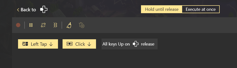

    I have a suggestion to add 4 buttons in the list of gamepad controls.
    I believe that Metal Gear Solid V divides the touch pad on the PS4 controller in 4 quadrants.
    I am using a 3rd party controller and PS Now does not recognize the touch pad.
    In the list of gamepad controls I can only map the left side or right side of the touch pad to a button.
    My suggestion is to add the following options:
    Upper left tap
    Bottom left tap
    Upper right tap
    Bottom right tap
    Have just checked Metal Gear Solid V from PS Now, and I have noticed that the game requires clicks instead of taps. Even though they show "bottom right and left" positions, both ones work with our Left and Right tap combined with a Touchpad Click.
    Please try the following:
    Create a combo in Hold until release mode that starts from Left Tap and then includes Click:

    This action is recognized by the game and works as a Pause natively.
    Then, make the same one for the Right Tap.
      Thank you.
      I had not realized there is a difference between a tap and click.
      The solution offered is indeed logical.
