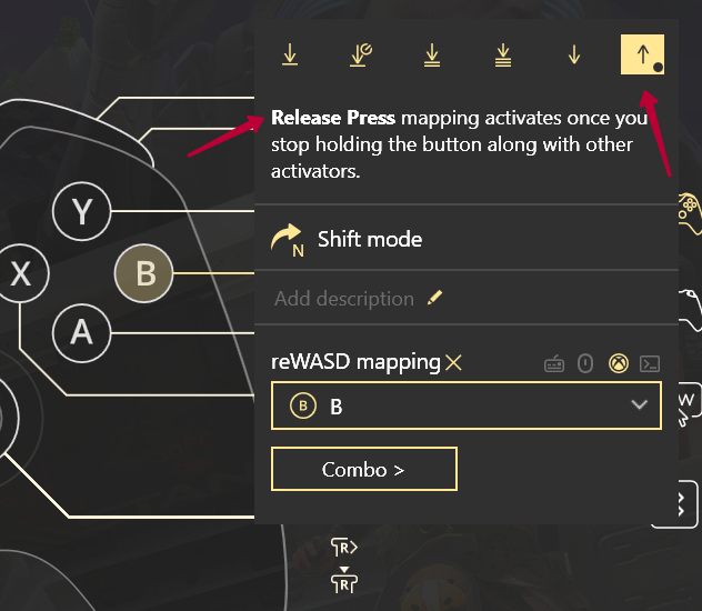

    Yes, it sounds possible. You will need to use activators. The regular Single activator should be mapped to B + Release Press activator should be mapped to B again. This way, once you release the button, reWASD will send one more press and release for B:

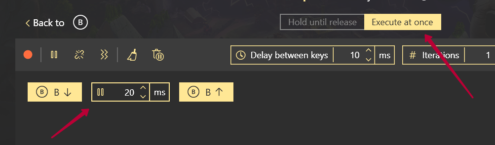

    Please note that sometimes the games do not understand this fast press, and so you will need to use Combo for Release Press instead. The Combo should emulate a bit longer press (20-30 ms is enough). It should be also mapped to Release Press activator:
