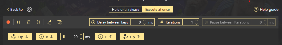

    If you want to switch to when you press the [B] button:
    • remap [B] on to this combo instead (increase the Pause node value if necessary):
      Click image for larger version  Name:	Screenshot 2022-07-25 011355.png Views:	0 Size:	58.0 KB ID:	233094
    • set the [Start Press] activator to change Shift to in Custom mode.
