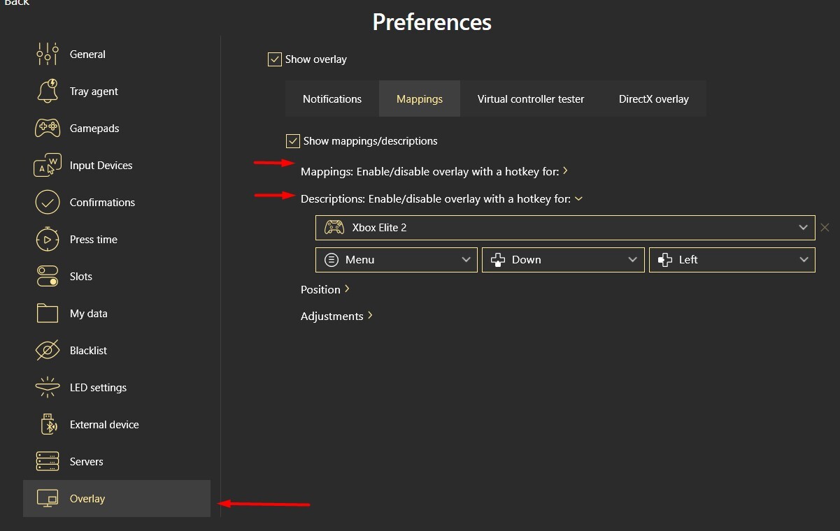

    2. The possibility of having the descriptions on the overlay.
    As you can toggle between "show mapping" and "show descriptions" when in the configuration of devices would be nice to have the same option on the mapping overlay.
    On the same note, the option to hide muted keys from the overlay or default ones to simplify something that´s taking screen space.

    2. Already in our plans, but no ETA. For now, mappings and descriptions have separate overlays but replace each other when activated.

      2. My bad, fantastic feature! (solved)
