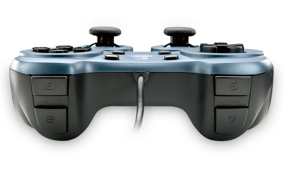

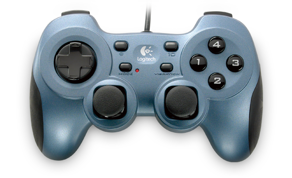

    Logitech devices have a nice, modern layout for DI labeling which is worth using:

    I think it's the last important Virtual controller from the past and after this, you can focus only on new significant devices or keyboards and mouses. 😉
