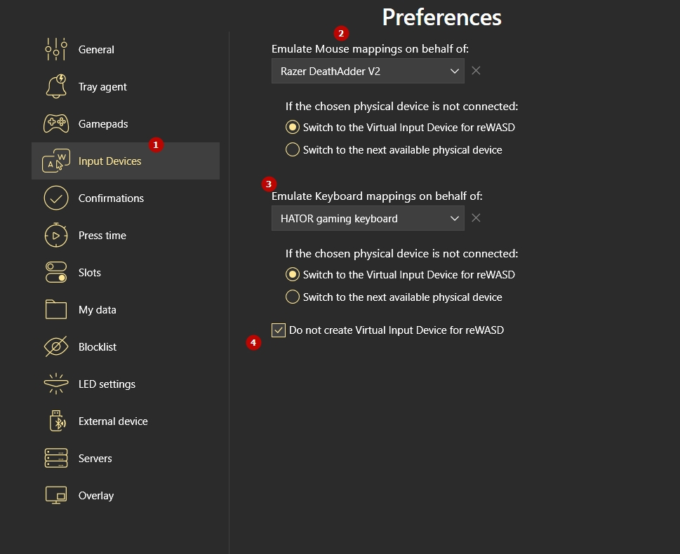

        It is possible to remove them and send remapped inputs as if from your physical devices with keyboard and mouse functions.
        Sounds interesting, how do you do that?
          Open → Input Devices and select your keyboard and mouse from the respective dropdowns.
          This won't add an extra keyboard and mouse like you wanted, but it will make the system accept virtual emulated input on behalf of your physical devices.​
