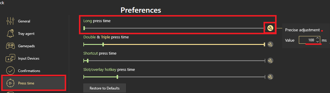

      It is possible to make the long press to go as short as 50ms at least? Since other buttons can go lower than that?
        You can reduce how long it takes to detect long press here(100ms is minimum):
        But I can't recommend it because it becomes hard to make Single Press.​
