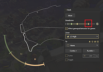

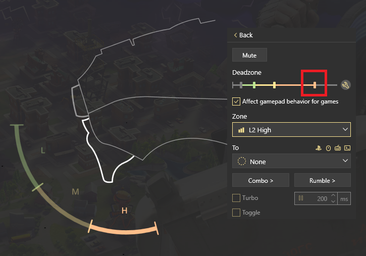

    Hello! Currently, you cant mute triggers in reWASD, but your first example is still possible to achieve with existing functionality via adjusting trigger zones:
    The more left the red mark, the sooner you will get 100% input.
