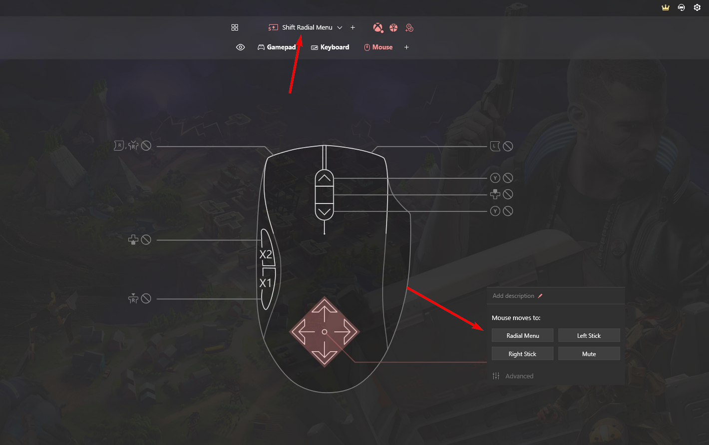

    As far as I understand, you want to use the mouse to navigate in Radial Menu. This is possible. All you need to do is go to Radial Menu Layer and adjust the mouse moves as Radial menu
    After this step, you will be able to choose Radil Menu sectors using your mouse ​

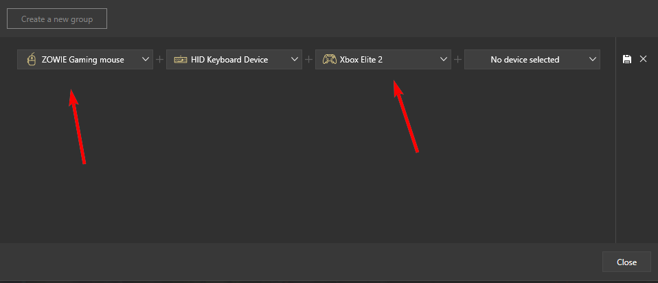

        Make sure that both devices are added to a common group of devices.

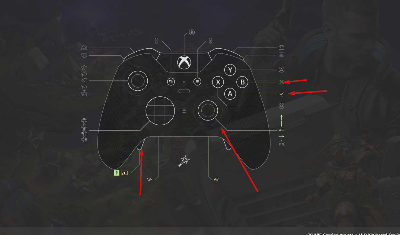

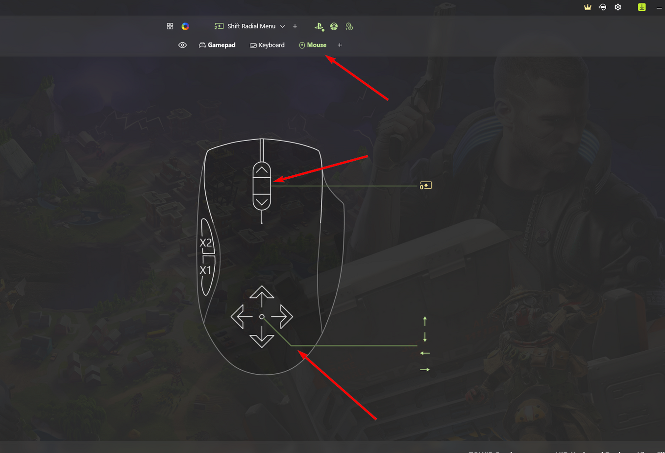

        For example, this is my setup. I can navigate in Radial Menu using the mouse and the right stick
        Click image for larger version  Name:	image.png Views:	0 Size:	15.9 KB ID:	240006
        Click image for larger version  Name:	image.png Views:	0 Size:	1,005.2 KB ID:	240007
        Click image for larger version  Name:	image.png Views:	0 Size:	1.03 MB ID:	240008
        As you can see, I can use the stick and mouse ​to navigate. ​​
          thanks for the reply! Yes, i grouped them together. And i did the same configurations like you. But for me, there does not appear any Ring Menu overlay when I combine both devices into one group. hmm
            I found the issue! If you have the group with an empty slot as placeholder like this:
            it does not work. If I put my mouse (usb receiver) to the third slot, it works!
            thanks for your help!
