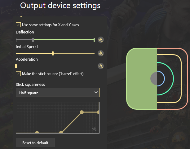

    Could you please go to the Output device settings, check "Make the stick square (barrel effect)," then select Half square and see if the same behavior occurs with this setting?

      Hello, even after switching to the stick square (barrel effect), then selecting Half square, this issue still persists. I can confirm that it's not a problem with my computer, as I've tried reWASD on multiple devices, and they all have the same issue.
      ReWASD didn't have this issue before. It seems that the problem started occurring sometime after the 2023 update, which added support for physical controllers. I'm not sure about the details, but it definitely seems to be related to that.
        Thanks for the report. We were able to reproduce it and will work on a fix.
          Hi! Fix has been added in version 9.0 ​
