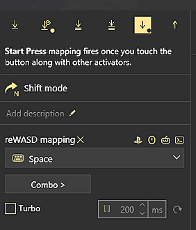

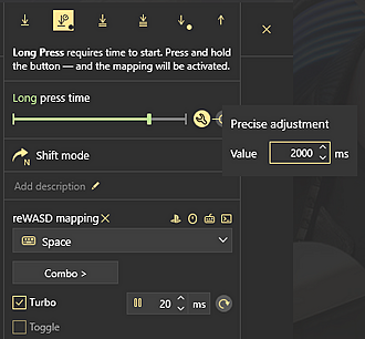

    What I want is for my hotkey to press Space immediately, wait 300ms, then continue to fire Space every 20ms until I stop holding the button down.
    With Turbo, I can get it to fire Space every 20ms, but I can't get it to wait the 300ms on the initial press before that turbo loop kicks in.
    Is there already a way I can achieve this? If not, it'd be nice to have the ability to setup something a bit more complex than what Turbo currently offers.
    There is no direct to achieve what you want, but you can try this workaround:
    1. Apply "Space" to Start press mode:

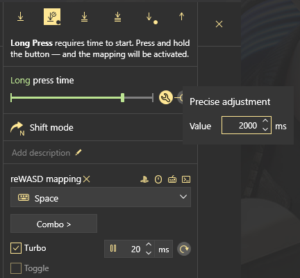

    2. Apply "Space" with Turbo+20ms delay to Long press mode and adjust press detection time to 300ms:
    After this, you should get the desired result.​​

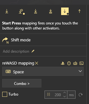

          Wow ... since when you can adjust Long Press for each mapping (instead of just Global settings) ... did not notice this
          Thanks for adding this feature
            That feature was added in 7.2.0!
