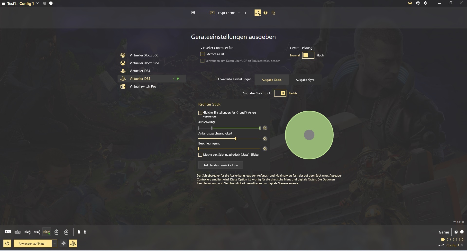

          Please send us a screenshot showing how you've mapped the stick zones and your device group.
            Virtual DS3
              Originally Posted by Veteran66 View Post
              Virtual DS3
              Considering the device on which the config was applied, I can assume that we initially misunderstood you.
              Can you describe in more detail what you meant by "set Axis as Button"?

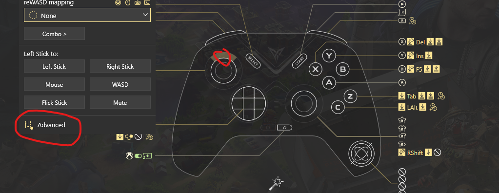

                        have you tried this:Click image for larger version
Name:	Controller stick-button1.png
ID:	243713Click image for larger version
Name:	Controller stick-button2.png
ID:	243714​first picture is only so you find the advanced setting for the sticks.

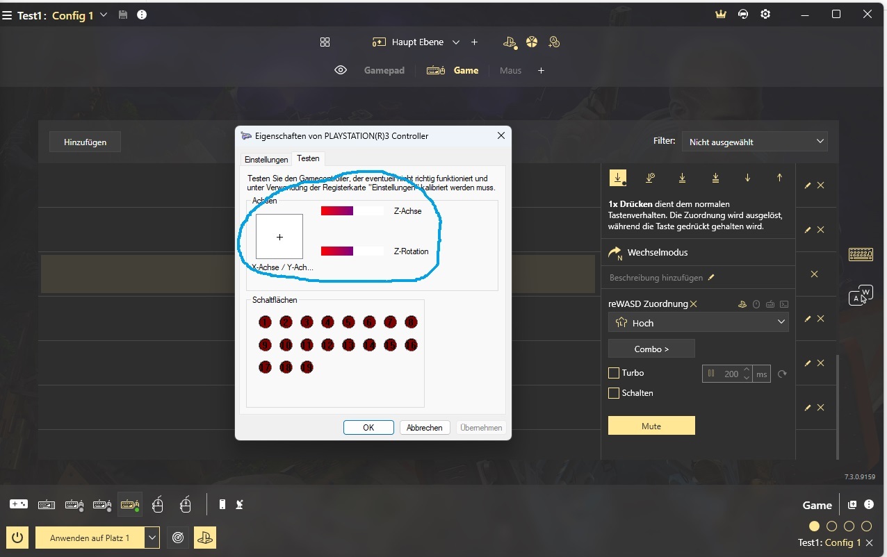

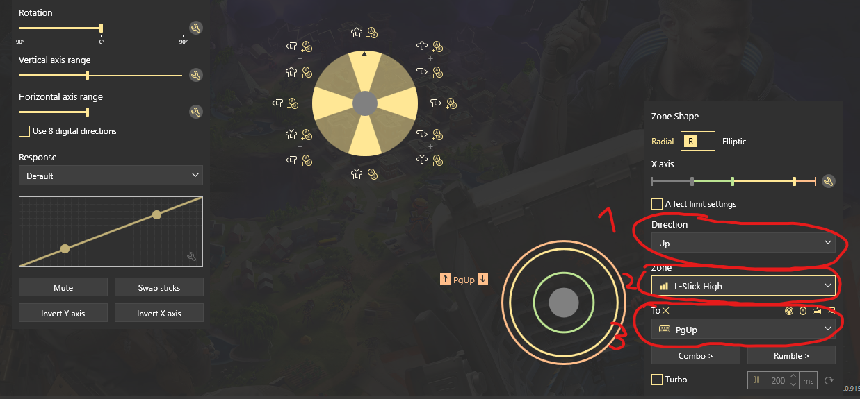

                        Second picture:
                        1. you set the direction you want to put an input in
                        2. you set the zone. High mean only in the last part (Between yellow and orange line) will trigger the key.) You can change the zones.
                        3. to set the key.
                        on the left you can change the stick to a 4
                        I don't know if this will work for you game. Maybe using the D-Pad for WASD might be better?
