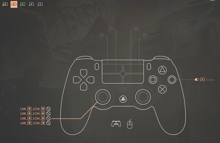

    Hi there! Sorry for my late reply. Here are some findings you should try to get the desired behavior:
    First, you don't need to use the second slot for such a configuration. It's better to use Shift mode for one config and one slot. Set "A" button as shift modifier and add combos for each and every direction. Seems it will be something similar to my pic below. Also, add Unmaps for the whole sticks. And I think it would be better to add Unmaps and Arrows to this stick in main configuration (Shift 0). If you want this Shift to be activated by pressing A button, you need to check "Toggle" option for the shift modifier. Then, you will be switched to the Shift 1 once you tap A button and you will be switched back once you tap the button again. If you don't check "Toggle", you should press and hold A button to activate the Shift 1 configuration. Nevertheless, you won't need to re-trigger the stick.
    Please check my findings in the game. Would be grateful for you try!
