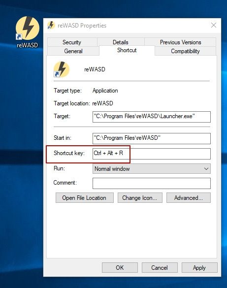

            reWASD doesn't allow you to map the exact application to the button right now (this functionality is coming soon, it's in our to-do list already), however, you can do the same with this trick:
            1. Go to the context menu of the app shortcut and choose Properties. On the Shortcut tab, add a few keys that will start it:

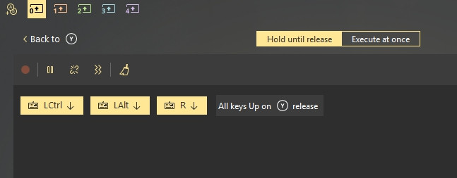

            2. Map the same shortcut to controller button using Combo in Hold until release mode:
            Click image for larger version  Name:	e5b5ef26b3.jpg Views:	0 Size:	23.0 KB ID:	216727
