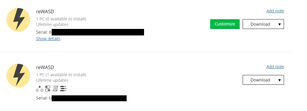

    I have two licenses of rewasd and I can't figure out how to change to my full feature license
    I have revoked my license and tried to uninstall re-install but it just keeps licensing "8" and I want to license my first purchase "6".

    Go to the C:\ProgramData\Disc-Soft\reWASD and remove the license.dat file. After it, open the reWASD and you will see the activation field where you may enter a required license key.
