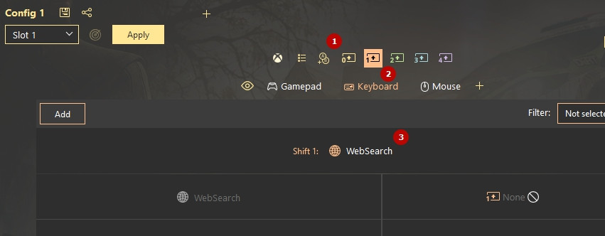

    Hi. I don't know if it is possible or I just can't find the option to disable the key that I assigned to a Shift shortcut. Example...L stick as a Shift key, but ignore the key event. Or, on a keyboard, WebSearch key as a Shift, but do not trigger the web search. It would allow me to set the Websearch key as a Shift, without messing with my Pc ( actually opening a web search).
    Thank You.
    Yes, it is possible. You just need to Unmap Shift modifier not inside this shift but in the Main configuration (Shift 0).
    Go to Main layout, choose WebSearch, for example, and turn Unmap on for this button (1). Switch to Shift 1 (2), you will see that unmapped WebSearch was inherited. Then, choose this button as a shift modifier (3).
