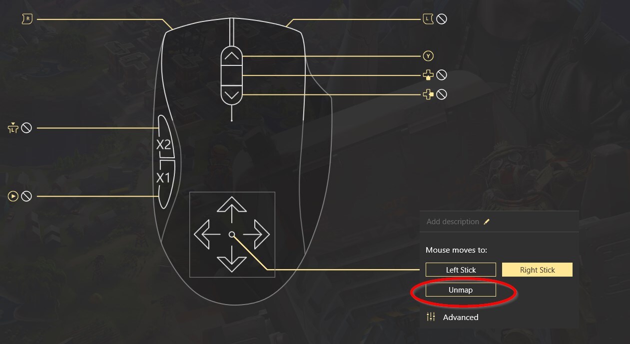

          Hello, I was wondering the same and come into this post after a search. Anyway I did not understand your reply, what you mean by "unmap this case"? My mouse simulates the right stick of the controller. If I click "unmap" (see file attached) the mouse stops working (reWasd also advise me before apply the change). Could you please help? Thanks a lot
Name:	2021-09-02 23_26_43-reWASD.jpg
            [Unmap] option would "mute" the initial input, stopping the pointer from moving around, which probably is what keeps it visible.
            For how to set up a key to switch mouse back to its native behavior - check this article.
