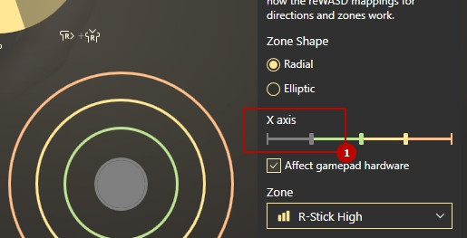

    In Advanced Stick settings, there is a slider that allows you to set different zones, including the deadzone. Grey part is for deadzone. Try different positions in order to achieve the behavior you need.
    Also, do not forget to check Affect gamepad hardware option if you play with Nintendo controller and do not have virtual mappings on stick.
