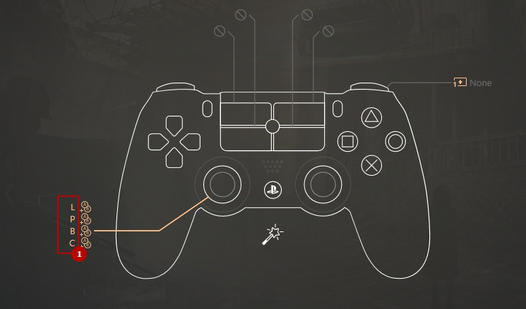

        First, map stick directions to the needed set of keyboard keys: L, C, P, B:
        Click image for larger version  Name:	2137932d75.jpg Views:	0 Size:	45.4 KB ID:	218056

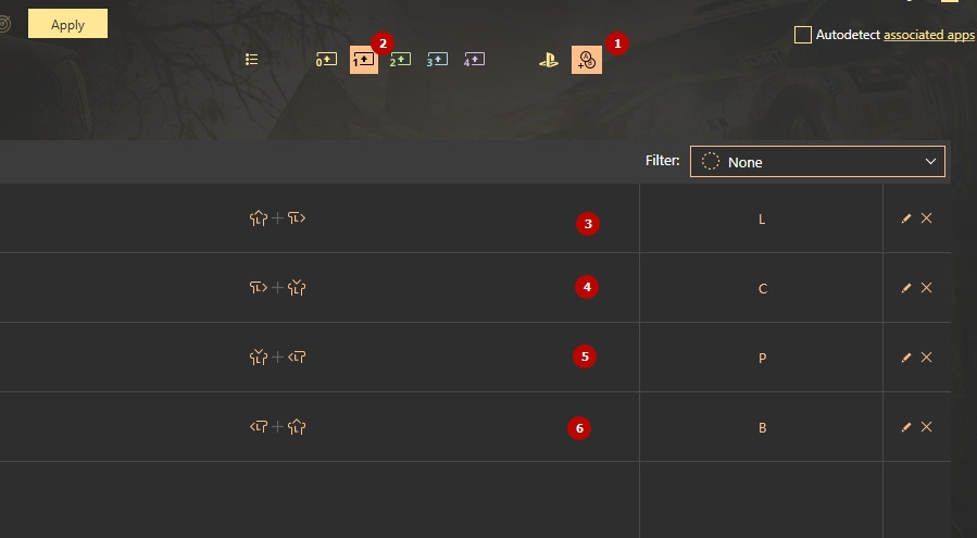

        Then, go to Shortcuts (1) menu inside this Shift (2) and set 4 diagonal shortcuts (Stick Up + Stick Right, Stick Right + Stick Down, etc). Each one should be mapped to L, C, P, B again (3-6):
        Click image for larger version  Name:	796e3bedf2.jpg Views:	0 Size:	44.1 KB ID:	218057
        This configuration will help you avoid the diagonal movements.
        Would be grateful if you try.
