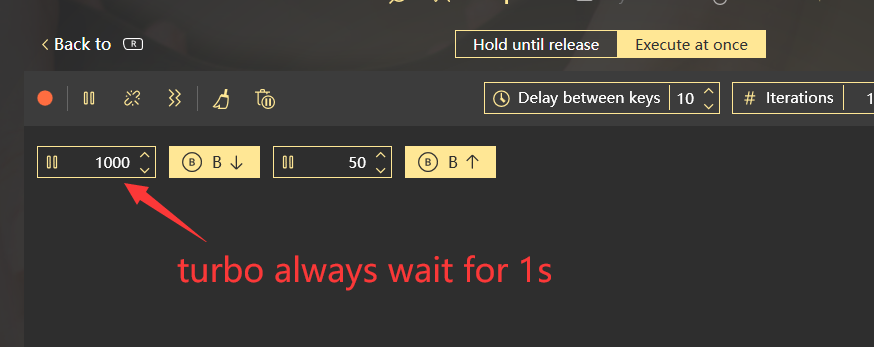

    When I use 'trubo' in my macro, I cant find a way to do a pause before turbo.
    For Example :
    (when I press a button) A -(wait 1sec)-> B -(50ms)-> B -(50ms)-> B....->B (loop)
    I have read all the tutorials, but this problem still bothers me, thank you for your patience.

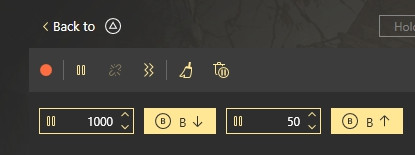

    There is one tricky protection in Combo Editor, it doesn't let you create a combo that includes a pause only, because this combo sounds useless.
    But, once you add any key to the sequence, the Pause icon is active, and you can add it. Then, you will need to drag it to the first place, like I do here:
    Then, the combo looks as follows:

      Thank you for your reply, what you mentioned is really useful.
      However, according to this method, [a long time wait -> short time cycle] cannot be achieved, because the long pause (dragged to the first place) are also included in the loop,makes the loop waits long
      In FPS games, I need to reload first (long wait) and then shoot (short cycle)
      Looks like I need to implement it with two buttons, It's ok, thank you

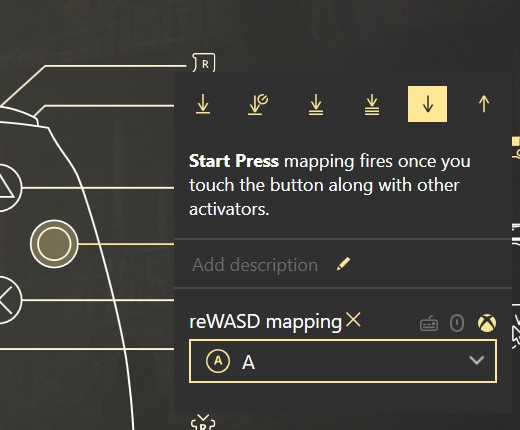

            Please set a combo as I've described you first: [1-sec pause] - B-down - [50-ms pause] - B-up and add Turbo checkbox to it.
            Then, go to Start Press activator and add A there:
            Click image for larger version  Name:	b4fe686fa3.jpg Views:	0 Size:	40.9 KB ID:	218075
              Actually, I have another one more idea :satisfied:

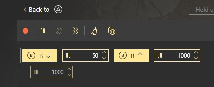

                You mentioned that you need 1 sec. t wait after A press. So, the A mapped for Start Press - > 1--ms pause, combo B button with 50ms, 1000ms pause - > combo B button 50ms - > turbo loop.
                If you don't need a sec. pause, please remove from the combo, you will have the same behavior without 100ms in turbo. But in this case, a combo starts right after A triggering.
                  If I set a 1000ms pause in turbo, and with Start Press, It will be like this:
                  Start Press -> 1000ms pause - > B button -> 1050ms - > B button -> 1050ms -> B button ->......turbo loop.
                  not like this: 1000ms pause - > combo B button 50ms - > turbo loop.
                  So in my opinion, the only solution is a manual job :satisfied:
                  If the 1000ms pause only once, it will be perfect
