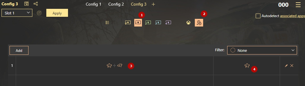

    Still, you can try to do what is needed using shortcuts in the shift.
    You will need to do something like this:
    1. Go to Shift
    2. Switch to Shortcuts
    3. Add Diagonal movements as a shortcut (you will need all of them, there's only one as an example on my screenshot)
    4. Map it to the command you need to be reproduced both on the normal and diagonal movement
    Click image for larger version  Name:	d33a02a5c7.jpg Views:	0 Size:	40.1 KB ID:	218173
    I hope it will help!

      And thanks for the little shortcut workaround. It isn't perfect but I can end up with 4 distinct zones on the stick, even if it is a little lopsided.
