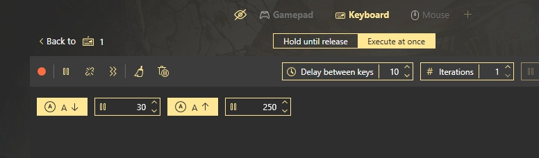

            Then, here is a combo I suggest. Here, A button is pressed during 30 ms, and then we have a pause — 250 ms.

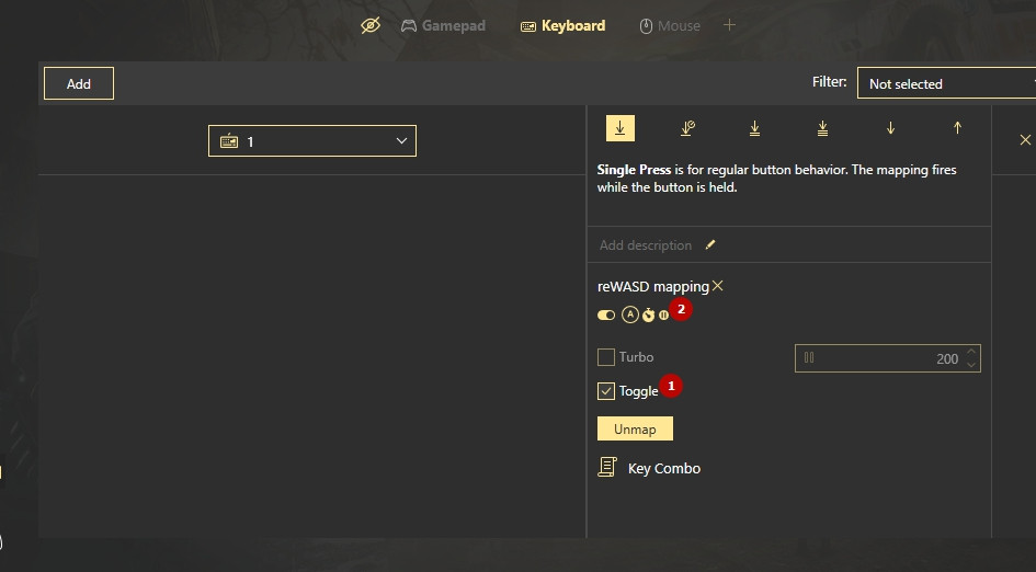

            On the next step, add Toggle option (1) to the button you use for this combo (2):
            In order to start this script, you will need to press "1" once. Then, it will be repeatedly pressing A controller button until you press "1" again.

              I am assuming that Iterations are loops, so if I set that at like 5, "A" will be pressed down and released 5 times with a 30 ms delay every 250 ms.
              How do I get to this menu and what is "Delay between keys"?

                If you need A button pressed 5 times in a row, then use the iterations instead of the toggle. The combo sequence is the same but please add iteration (2) option which is the number of times the combo reproduces after the single press (5 times in your case, please, see the screenshot). Also, you may add pauses between the iteration if you need it.
                The delay between keys is the pause that will reproduce between the elements of a sequence. Basically it is the same pause that you set manually between elements of a combo, so you may set as zero if you prefer to add pauses between combo elements by yourself.
