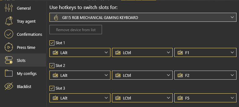

      To change a Slot i need to execute a Hotkey like L-Alt + L-STRG plus eg. F1
      If i add this combination as a Macro and add this Macro to eg. G1 its just not working
      In reWASD i cannot bind a Slot to a single Key like F1 - it just wont let me...

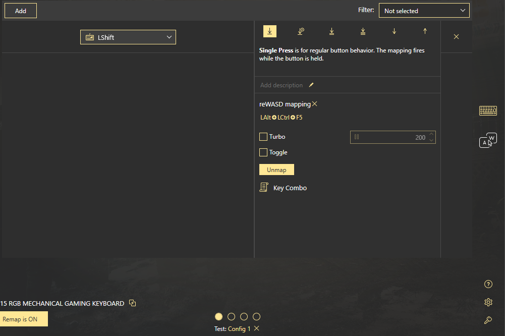

        Ok cannot edit the Post before (Please Delete it)

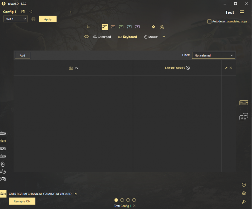

        Ok.... Im doing something wrong....
        • Choosed the G815 in reWASD
        • From the "Burger" Pulldown adding a New Config called Test

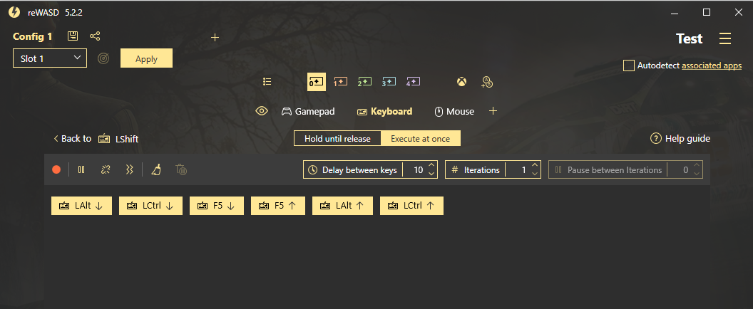

        • Choosing The F5 Key - And to Left i have added a Combo
        In Slots the Combo is set to F5
        I have added the G1 to F5.... and..... nothing
        Also uploaded the Pix from what i did
          btw i know its Lshift but saved is f5... looks like i hitted this accidentally
            The Slots changing work differently and there is no option to set it in combo or other different ways. Slots change with hotkeys only, that contain 2 or 3 controls (buttons). Mostly it was implemented to prevent accidental slot switching with a single button while gaming. We have plans to add some custom commands where any combo would be allowed to use. But it would be added next releases.
