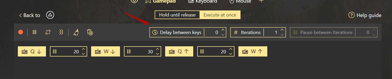

                              Once you recorded a combo, ensure that the Delay between key is set to zero, so no other pauses are added to the sequence you have:
