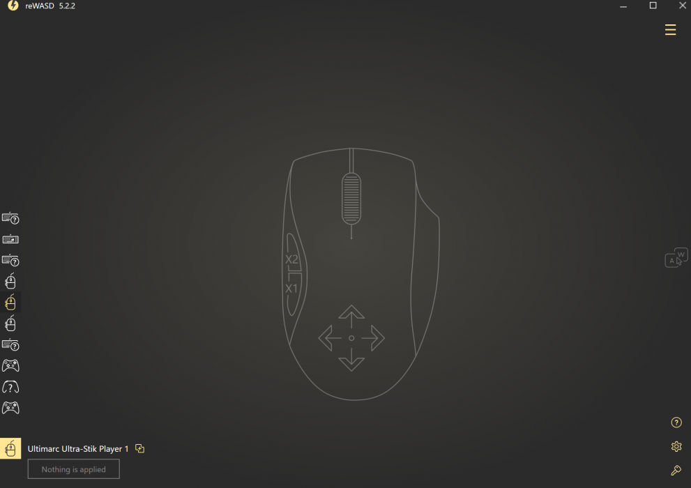

    I'm looking into how I can create a virtual controller pulled together from the ultrastik joystick and buttons from one of the other controllers on my arcade cabinet. Unfortunately, while rewasd doesn't outright consider it an unknown device, it is detecting it as a mouse.

    1. Does the Ultimarc Ultra-stick is detected as a mouse? May I ask you to take the screenshot of the main reWASD Windows where all devices are connected.

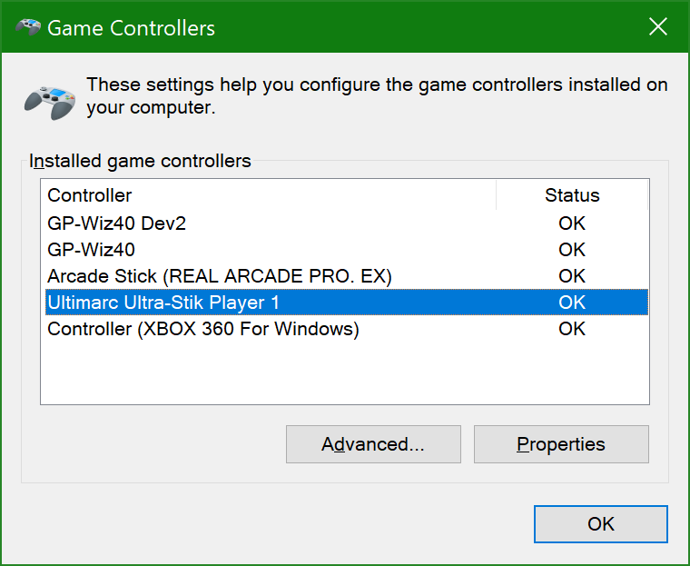

    2. If it detects as a mouse have you tried to set any mappings to check whether it works (like set controller mapping and check it with joy.cpl)?

      Here is the screenshot as requested...I've also added my joy.cpl list, so you can see it there, as well.
      I'm still familiarizing myself with the software, so hopefully I tested the mapping correctly. Joy.cpl shows a single box for the analog movement, which I see tracking to the movements of the joystick...and its 8 buttons (which are not connected to anything, except one I'm using to test, button 1), just so I could see if rewasd mapped it to one of the mouse buttons. I also moved the stick, to see if it mapped to the movement of the mouse, but in both cases I didn't see anything light up on the mouse in the center of the screen, like l saw when setting up my 360 joysticks.
      As for the connected devices, I have those 5 controllers connected, a mouse (ultimarc optitrak board with a trackball connected), an ultimarc Spinner (usb), a magic keyboard and a Rii keyboard. I'm assuming the unidentified controller in the list is the gp-wiz40/dev2 (from groovygamegear, which I use for my rotary joysticks, but are not ones I'm too worried about for now).

          - Open joy.cpl (https://html5gamepad.com/ is also a great debugger) and press controls on both devices to see responding inputs.

              According to the file the Ultrastik reports as two devices - mouse and gamepad in the system. reWASD does recognize the mouse but not the reported controller. Here some log details:
              Description: HID-compliant game controller
              Container Description: Ultimarc Ultra-Stik Player 1
              ContainerId: {6b43c171-6e0f-5d41-b085-aeebe7fd4656}
              ConnectionType: Unknown
              BatteryKind: Unknown
              BatteryLevel: Unknown
              BatteryChargingState: Unknown
              So, it possible to use this device like the mouse (I guess you may remap the buttons of the device), but, unfortunately, not like gamepad as reWASD doesn't support this specific controller. For now.
