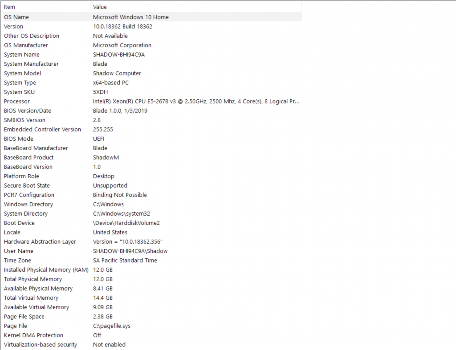

          1 - PC Config
Name:	Screen Shot 2020-03-25 at 11.48.51 AM.png

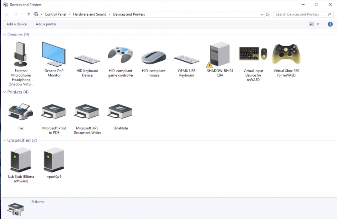

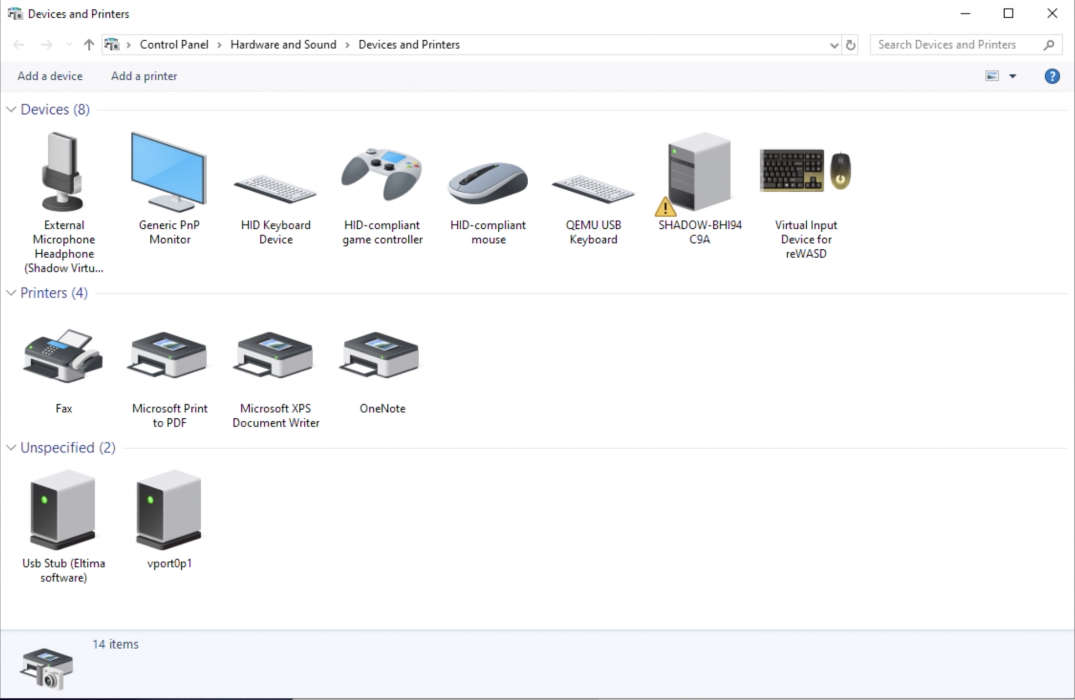

          Devices
          Note the "Virtual Input Device for reWASD". Not sure why it shows up. reWASD is launched at start, but not sure why it creates a virtual input.
Name:	Screen Shot 2020-03-25 at 11.45.24 AM.png

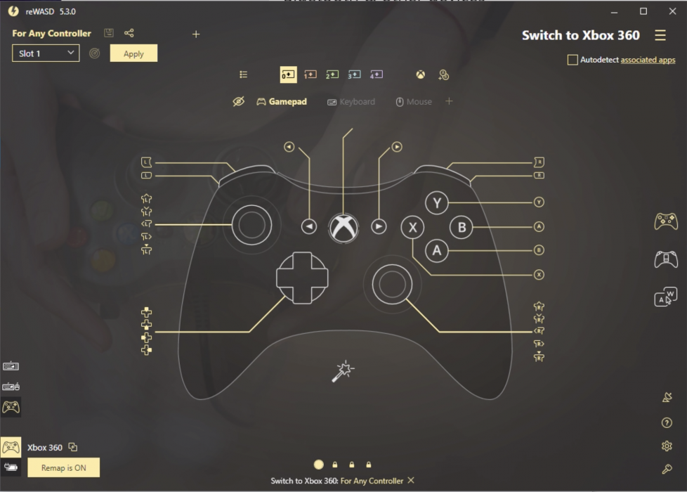

          3 - Remap: ON
          Now, I open reWASD and put "Remap: ON". Here's my config. I just want to switch A and B for now, because they are reversed as Window thinks it's a Xbox controller.
Name:	Screen Shot 2020-03-25 at 11.47.56 AM.png

            Devices
            As you can see, the new virtual controller is detected too.
Name:	Screen Shot 2020-03-25 at 11.48.11 AM.png
