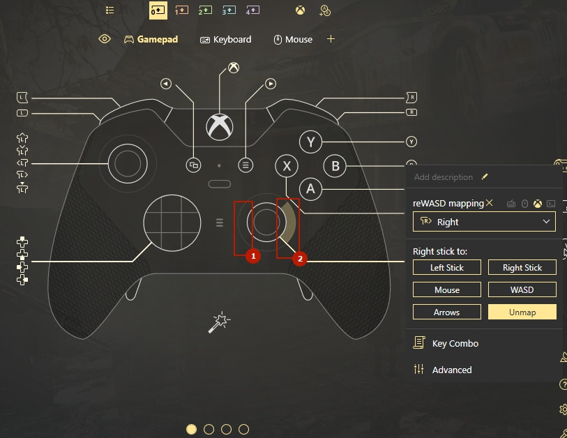

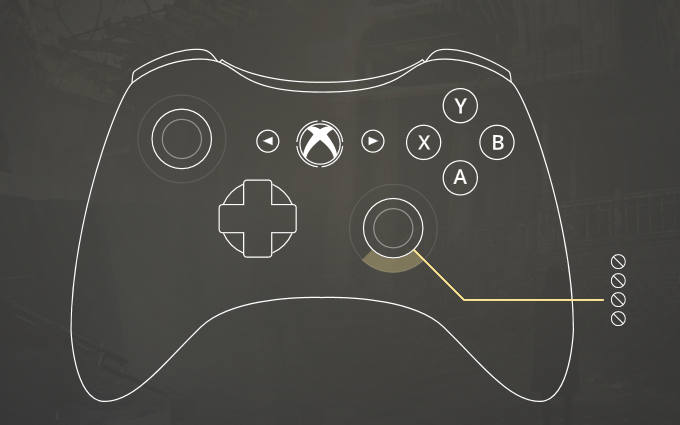

    the RS of my Xbox 360 has a problem, it always generates output all by itself, and it always goes down, so I just want to unmap the Y rotation (Highlighted in Pic) Click image for larger version
Name:	Annotation 2020-04-01 150853.png
    BUT when I unmap this whole right stick will be unmapped,
    Is it possible to unmap just one direction of RS?
    please let me know if theres any other solution.

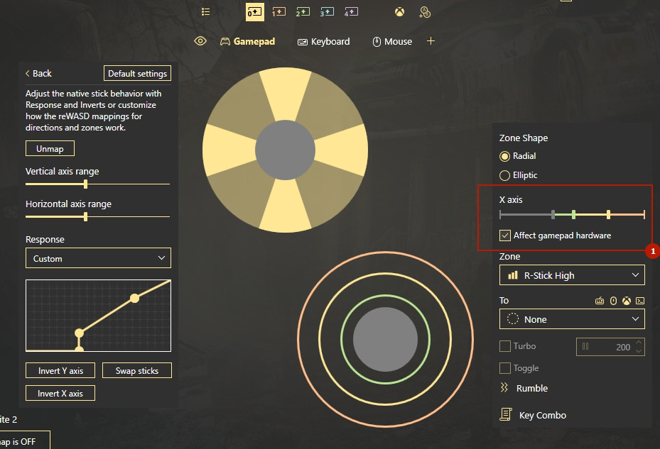

    As I understand, this is a kind of hardware issue with your controller?
    You can try to increase the deadzone for the right stick, it may help.
    In Advanced Stick settings, increase the grey zone and check Affect gamepad hardware option:
    If it doesn't help, here is another option.
    1. Unmap the whole stick (like you've already did)
    2. Map Right Stick Right and Right Stick Left mappings to the physical right and left, while leave up and down without additional mappings:
    You will be switched to the virtual controller with disabled Y axis for the Right Stick.

      It worked, Thanks man! just what I wanted
        You are welcome :satisfied:
