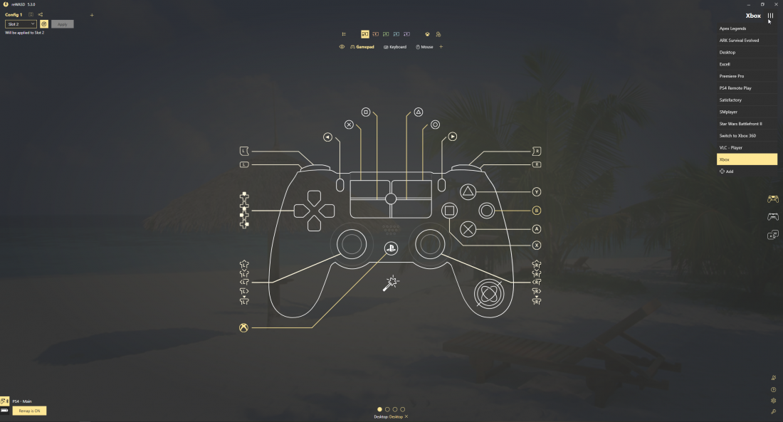

Hi i have a ps4 controller tryning to get it to work whit Far Cry 5, and have set it up to a simulate Xbox controller, it does registrate the game and sweeps over to Xbox, but nothing happens when tried to use the controller in game, do anyone have any suggestions how to get it work?
Far Cry 5 simul8not working
Do use the native controller without additional mappings or some mapping were added in addition, like some keyboard buttons? May I ask you to take the screenshot of the config?.
So, the game reports that this is an Xbox controller (like you see gamepad menus buttons to navigate), doesn't?. Can you navigate the game menu? If not, maybe the game didn't pick the controller and restart the game will help.Don't worry! Be Happy!
