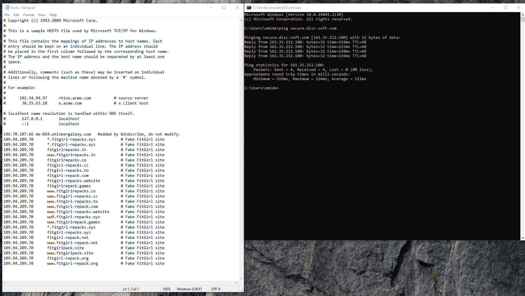

    Please go to C:\Windows\System32\drivers\etc and open the file hosts via notepad. Please check that there are no hostnames related to daemon tools or take a screenshot.
    To be sure that you have access to our server please do the following:
    - open cmd and type ping secure.disc-soft.com to know if our server is pinging by your PC.
    - turn off (temporary) all antiviruses that are active or work background. Like Windows Defender and other ones if they are installed on the PC.
    Let us know if the problem persists.

          How do I do this? If you mean to use DNS, I tried it, it gave me a license error. If you know another way, send me a picture so that I can understand it better. I really appreciate your help.​
            plz help me i cant active licence
              Could you send a screenshot of the error you are getting?
              Also check if you have tried using a VPN to activate reWASD and disable the Eero Security service in your router settings?​
